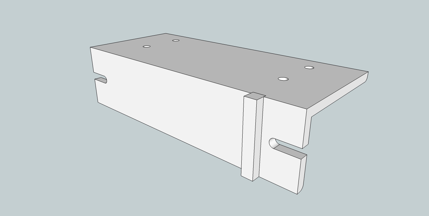

    I'm still planning on making this jig. 3x5 x 3/8 T6 aluminum structural angle. Meant to be bolted down to the spoil board after a recent surfacing to keep square and then removed. I may find it a permanent home on the left side of my machine in the extra 12". Most likely after i strip and rebuild my bed.

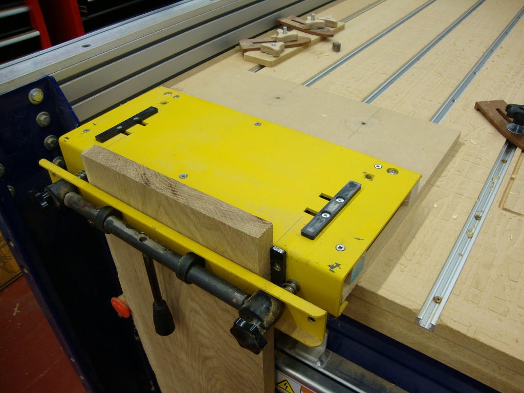

    What might be easier is just look on ebay or in craigslist for an old dovetail jig usually around $20.00 and remove the comb and use it.
    That's how I did mine. Definitely the easiest way.

    I don't actually use it for dovetails. I use it for VCarving on the edge of products and for mortise/tenons. I do have a clamp for the horizontal part but I don't use it typically.
    I made a right angle zzero-type fixture that I clamp to one end of the board and then use that to get the right hand edge and the thickness of the board set. Something along those lines would work for dovetailing as well I think.
    I got the original idea from Gary's blog article - http://www.shopbotblog.com/index.php...d-mortise-jig/

    I like the cam vise action on that Jig. As far as my design, i have the scrap laying around but haven't milled it. Not running into the need. When i do it's just waiting to get done.
