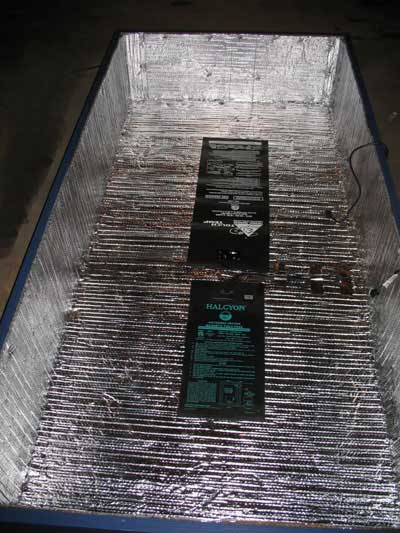

    The basic tank portion consists of a sheet of 3/4" RTG sitting on 2X4 treated studs. Side walls are 1.375 thick MDO fastened to each other and the base sheet via 2" X 1/8" AL angle and Kreg panhead screws. Inside the tank it is insulated with Reflectix double bubble foil insulation. Two Low or Zero EMF waterbed heaters were installed and the thermostats tucked under the insulation. The outside of the tank was painted navy blue (some say ShopBot blue)

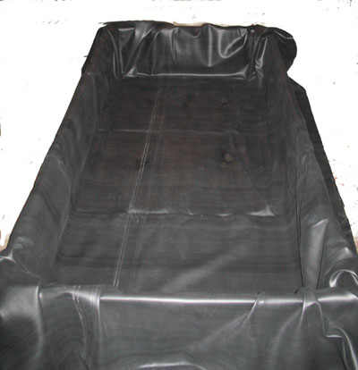

    Then a Firestone HDPM fish-safe (no outgassing in water) was fitted to the inside of the tank. It is retained by staples along the top edge of the 1.375" MDO and then capped off with AL angle.

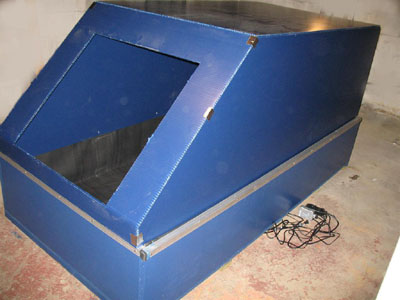

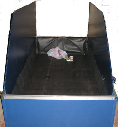

    Then the top sides were cut using a 1/4" downcut 4-flute cutter out of 10mm coroplast. Panels are notched at the bottom to sit on the AL 'ring' that caps off the liner. Stainless screws and hardware was used to fasten the sides to the bottom MDO ring of the tank. Finished tank size overall is about 4 X 8 X 4 feet. I'm glad I made it that big...

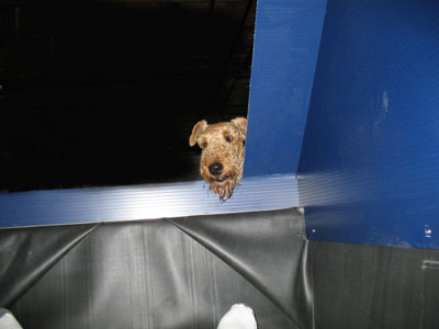

    The rest of the Coroplast was cut and adhered to the sides/each other using foil tape. This was initially just to tack it in place, but it worked so well that I just rolled with it. So far so good. Here's me laying in it to see how well I fit...Grover is looking in wondering why I built a big crate
    Here's what it looks like from the outside. The 2 digital waterbed heater controllers can be seen on the floor. They need to keep the water at exactly external body temperature - 93.5° F. The sloped roof helps condensation roll gently down the back.

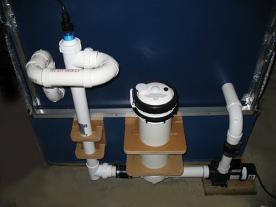

    Here's the business end of the 'water works' in the back of the tank. On the left is a UV sterilizer, in the center a canister filter, and to the right a salt approved pump. Notice the groovy clamps I made on the Bot to hold everything. Also note the Reflectix insulation (you can just see it) that is covering the entire deal on the sides. The entire box was covered 2X in Reflectix. (not shown)

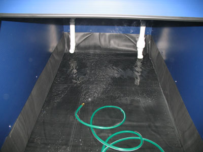

    Here's the inside of the tank while I just started filling it up. The solution level needs to be about 10" high. I brought it up to the 5" mark.

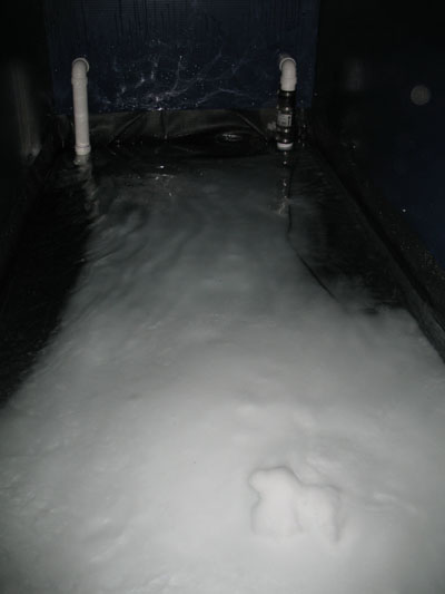

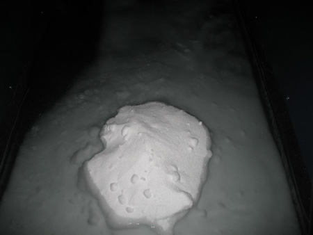

    Now we start to get into what most think is the 'crazy' part of the project. 900 pounds (yes that's correct) are added to the solution slowly over the course of 2 days. The water was about 91° before adding about 400# of salt. Right after, the temp dropped to 68° !!! Salt was agitated by hand to disolve into the water. Then the remaining salt was added. Check out the MOUNTAIN of salt!!! The salt was SO COLD while disolving that my fingers needed to take a break to warm up. Imagine a pile of snow under water.

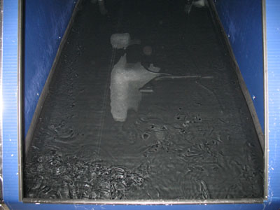

    All of the salt is nearly disolved and only a little remains. The patterns in the water are from the circulation pump doing it's thing. It only runs when you are not in there.
