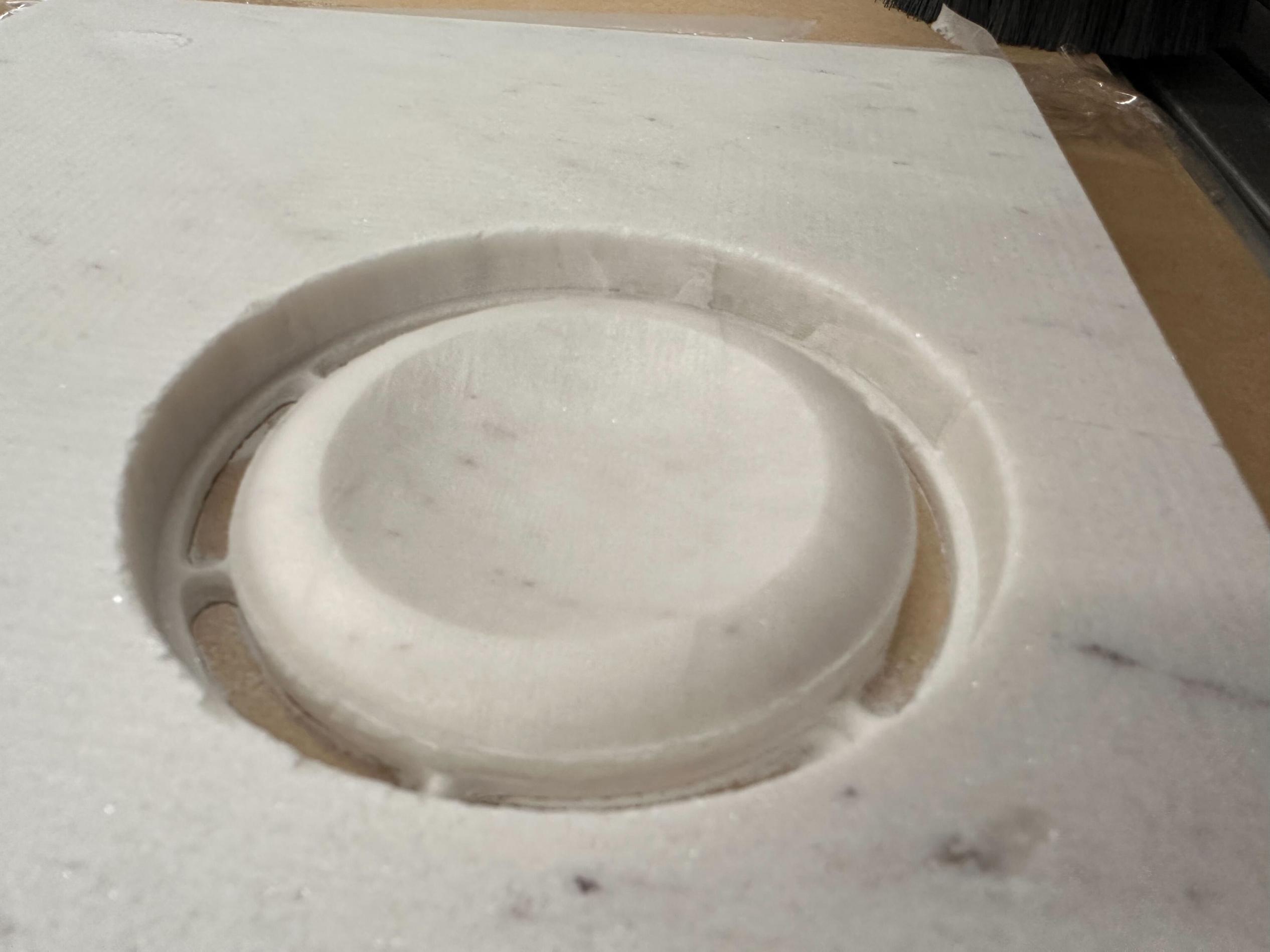

I've got someone asking me about cutting marble slabs and/or cultured marble with a ShopBot -- I've done diamond etching on a granite surface before (I know marble is softer) but I haven't tried milling a stone before. I'm imagining that the cultured marble would be similar to G10 -- anyone with any experience?

2 Attachment(s)
I gave it a try with just some old bits that I had lying around -- a 2-flute straight cut for the roughing and a ballnose 1/4" for finishing. The roughing bit was toast by the end of the cut, but the ballnose survived just fine. If I had a better bit for roughing I think I could do this in a cost effective way...but the dust created is not great. Attachment 35687Attachment 35688
Could you use some water to keep the dust down
Yep,
Dust is BAD for lungs and bearings!!!
I wouldn't do this as a regular gig, that's what a wet CNC is for(and they are messy!)
One thing Brady mentioned was not to use compressed air(use vacuum) as air pushes dust into shop air and bearings. WOULD use an N95 or better.
