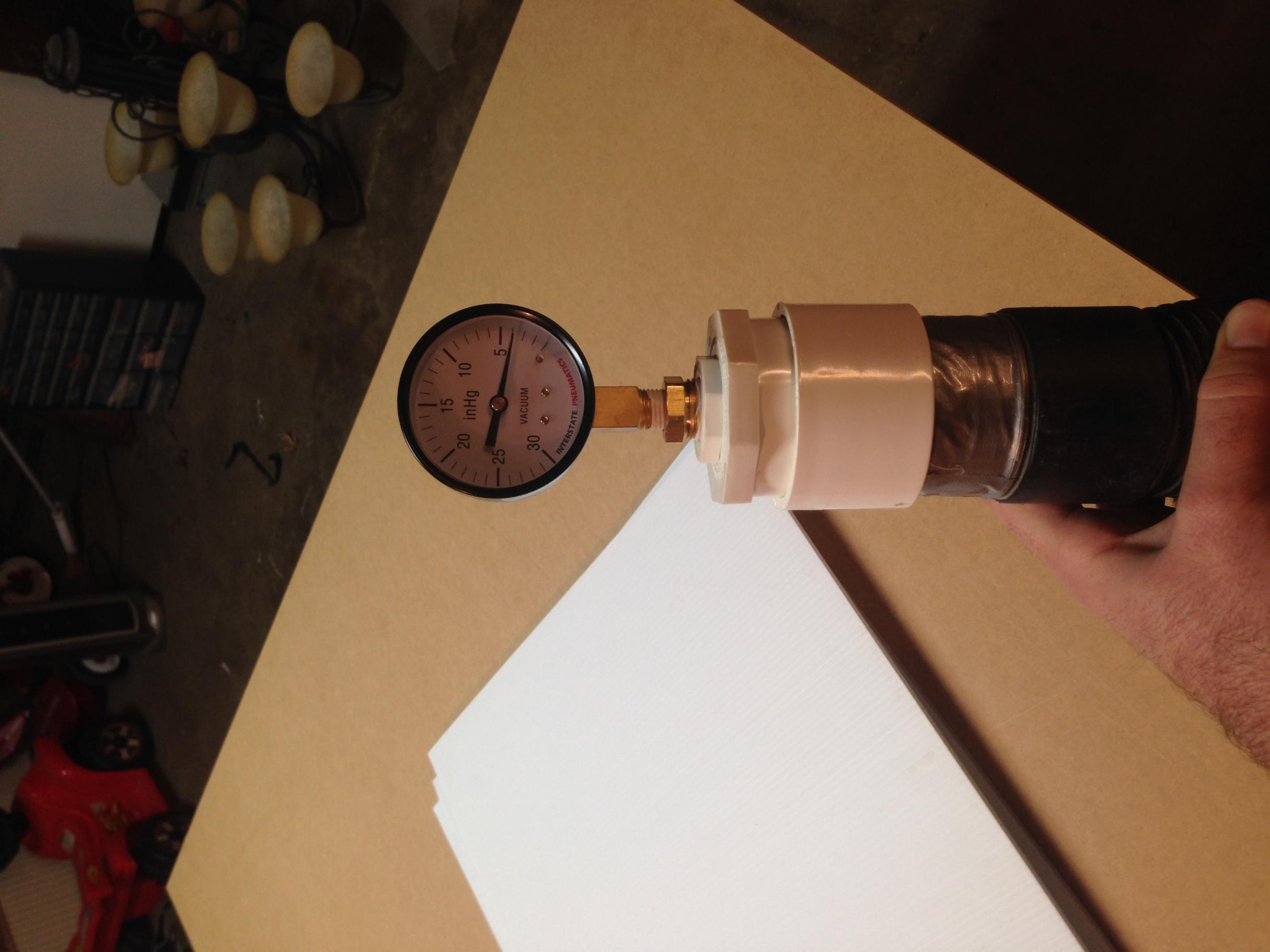

Thank you, that is what I like to see on the forum. Some experiments and the outcome. I am totally new to vac hold down. When I first got my plenum and spoilboard and piping complete I hooked my shopvac to the manifold and was pulling 3hg with the zone totally covered. However, the edges of the zone was not sealed, and PVC was not glued. So your test tells ME that I was losing 1hg somewhere in the edges of spoilboard and/or the not yet glued PVC. I have the PVC glued, box done now with filter. Today I plan on hooking up the box (FINALLY) to my manifold and let her rip. Although, still have not sealed edges of spoilboard but it is interesting to see first hand the results of how much leakage can come from different parts of the puzzle.
Thanks for sharing the pic and description.
