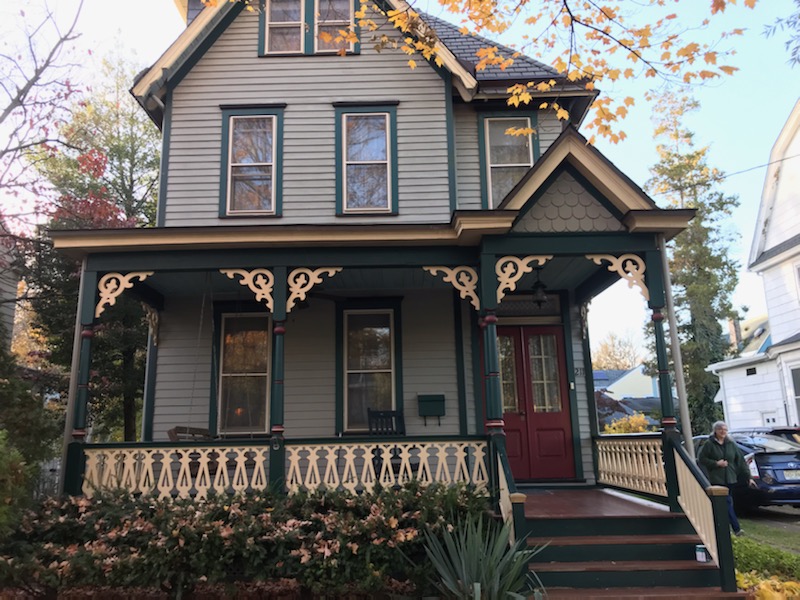

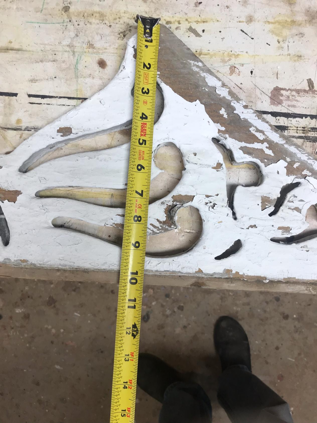

This job is to replicate some victorian corner brackets, so it's all thru-cuts. It's one corner bracket that gets a mirror copy. if the customer likes the sample, there will be at least nine more pairs for this building. And them perhaps more groups of ten pairs down the road. I've attached a picture of some PVC brackets/railing pieces we did for this customer and then the bracket that i have to replicate. I'm going to assume that I'll need to put a sacrifical layer under the mahogany to avoid tear out. the customer gave me a 12" x 12" X 1" piece to play around with. At least he gave me a template cut out of 3/8" material. I'm going to trace it and see how well the Corel auto-trace program will work. If it takes too long to clean up, I'll send it to the Vector Doctor. He always gives me nice clean files.

Except for the fact that the painter is going to Heck,and one spot I see, the wood looks good Rocco.
Doesn't look to hard to do from scratch(and mirror)compared to a trace.

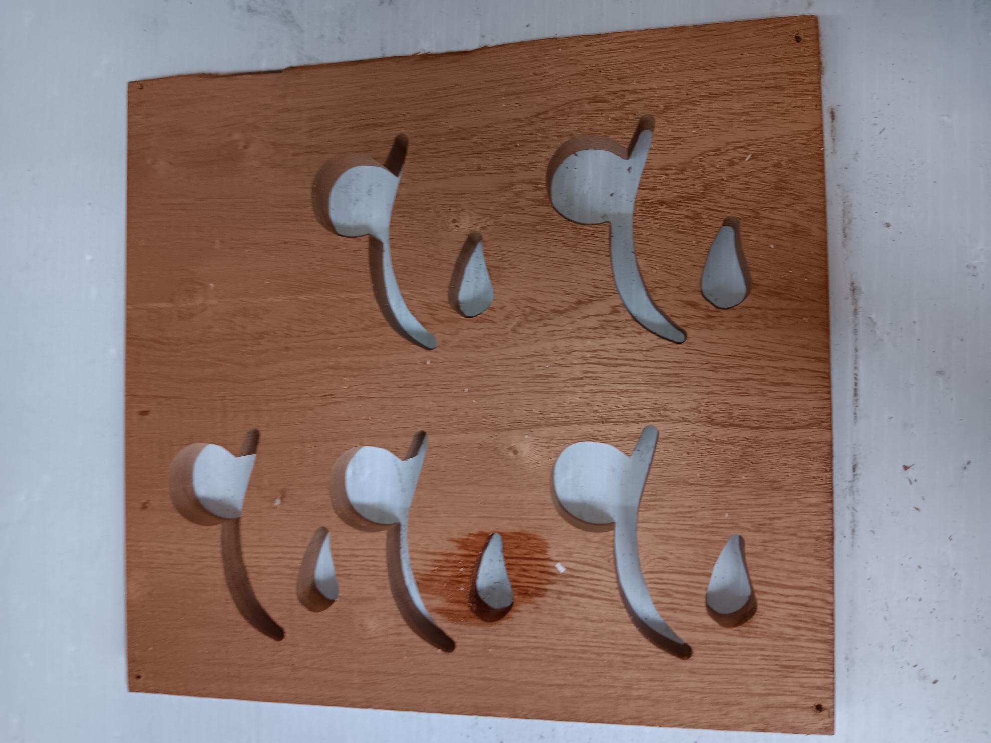

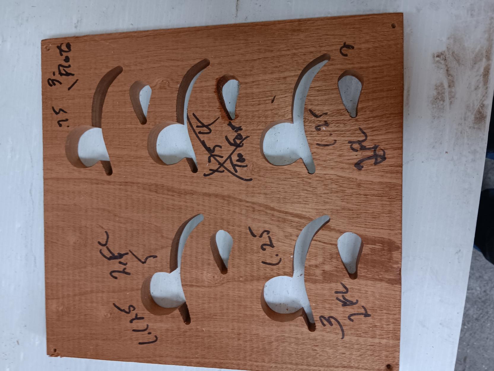

i did some test cuts with bits that i have, just two of the smaller inside curves. i tried a three flute bit (not sure of the exact item #) and also a two flute aluminum cutting bit. Both cut nicely and didn't tear out unless I went beyond 1.75 IPS. IIRC I was turning at 12500 RPM. Photos are below of both sides. The section that looks like tear out was just a wet spot. I use coroplast under whatever I'm cutting so I don't go into the bed. Some 3m spray glue holds the material to the sacrificial sheet. I learned this trick from a friend who has an older Gerber machine and no sacrificial board. If he cuts into his bed he might damage the vaccum strips.
My customer made a template out of 3/8" plywood and I tried tracing it but I had too many stray points to clean up, even after using the Corel auto-trace routine. i eventually took a scrap piece of black sign vinyl, traced and then cut the pattern with an exacto, pulled out the cuts to expose the white liner. Then I stood on my work table and took a photo straight down. After another run through the auto trace, it didn't take long to clean it all up.
i didn't ramp anything, just a straight profile cut for the tests. With the corrugated plastic underneath the wood, both sides were pretty clean because the last pass was deeper than the wood. The one that looks like it had tearout was just a wet spot on the plastic sheet. For the perimeter I'll leave tabs but I suspect that the vac would hold it.

Looks clean Rocco....welcome to wood! :)
